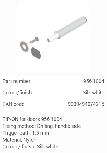

Question for anyone who is a Blum expert I think.
I have some drawers that use movento with blumotion.
So they are soft close
I am replacing the fronts, and don't want to put handles on, and was wondering if the "tip-on" inserts that you put into the cabinet frame would work?
I've not seen any solutions or product specs that show these two combined. Normally the drawer runners have a special mechanism added for push to open, however they are expensive, and I already have some of the little inserts:
Given they state "doors" on them, probably not appropriate, however I thought it might be worth checking....
I believe that (apart from rather pricey electrical motor driven ones) you cannot have soft close and push to open at the same time because the soft close stops the drawer/ door before it reaches the push to open bit to close it, if that makes sense.
Are your drawers overlay/lay on?, push to open draws are inset, as they need to be pushed back into the draw space before they will come forward.
Maybe look at a finger pull option for the fronts.

Blum sell a little fixed buffer that fits into the back of the door or drawer front that creates the 2.6mm gap. It fits in an 8mm dia hole.
They also sell a buffer that is spring loaded that allows you to maintain the same gap but also allows you to push the door or drawer front to activate the TipOn mechanism....
Blum part number 993.0830.01

This is what I used for the servo pullout drawer, although it sometimes takes several attempts. The drawer has to be set up really perfectly.
Looks like I need the proper tip-on for movento accessories for this then...
