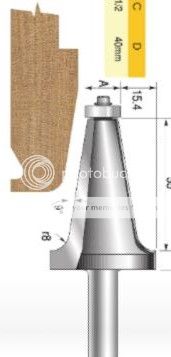

Hi All,
I want to machine the following profiles on my router table but I'm unsure of the best way of supporting the work piece on the outfeed side of the table.
For the above profile I intend to machine a low level sub fence to support the base of the profile, unless there's a better way
However for this profile I can't see a way of supporting the outfeed without machining a subfence with the corresponding slope, so I'm looking for suggestions.
Thanks in advance
Chunky
Just feed the work piece through between the fence and the bit instead of over the face of it.
You have to go the other way (left to right) though or it'll kick back.
