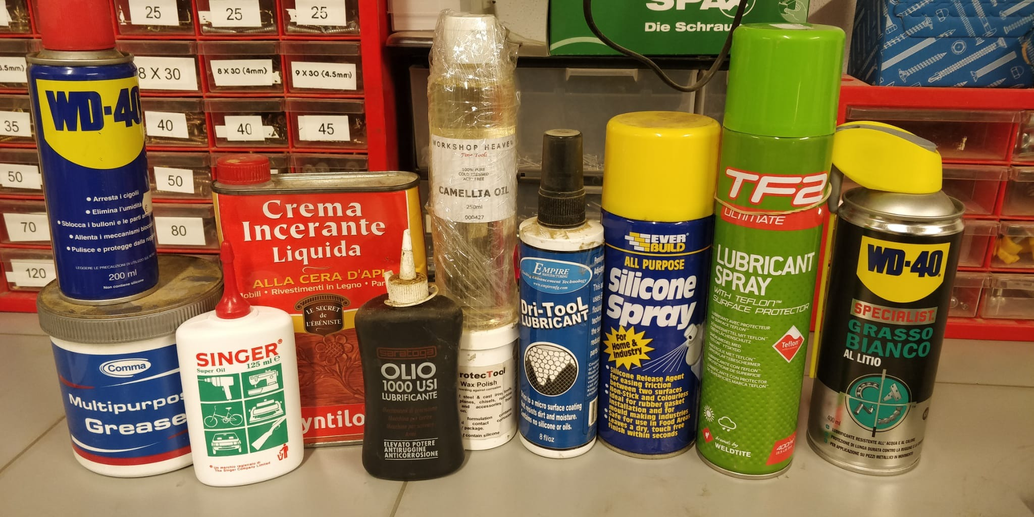

I have a Harvey cabinet saw, and finally got around to cleaning the innards.
It's a bit like this without the router table:
Despite having excellent dust collection, I pulled out an entire wheely bin of dust and debris, and am ready to clean and maintain the moving parts.
They always come covered with grease, however I think that attracts dust, so was wondering what you might all recommend, and any different products for different areas of the machine (inside)?
I have a few products to hand:
WD-40, grease, machine oil, liquid wax, general oil, camellia oil, protect wax, dri-lub, silicon spray, spray for bike chains and spray lithium grease.
I am inclinding towards the lithium spray at this time, however any thoughts greatly appreciated!

The lithium grease is probably the best
Thanks, spray on one also?
I can of course get something else, I don't mind, there may be little difference between different products, however I defo learned not to use silicon spray on some things, and not to use wd40 on others....
If there's an ideal option not in my stock, happy to hear about it!

For those parts I use PTFE spray on my Wadkin. Dry so it doesn’t attract dust but still keeps things moving nicely. I think I got mine from toolstation for about a fiver. You can also use something similar called GT85 from Halfords/bike shops. It’s a spray lube for chains that contains PTFE to help keep grit from sticking to them.

You can see from the pictures, I've got the top off my table, which means the main top, the sliding table, the right wing, and the extension wing are all off. (I think the total width of top is about 1.8m of mostly cast iron). So there's no risk of contamination. Also plan to wax the top before next use.
Thanks all, been helpful!

I'm using some SHIELD TECHNOLOGY PROTECTOOL WAX.
I've never had a problem with stock sliding, this is only for rust prevention.
Only problem is, spreading it now is quite hard, it's now 8 deg in the shop!
