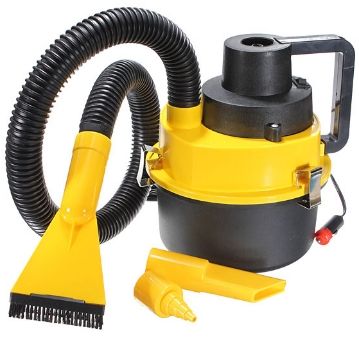

Hi,
I'm still getting set up with all of my scrollsaw hobby equipment and came across this little hoover after hunting for a quiet vacuum cleaner to connect to my Hegner and to clean up the sawdust in my shed. It's a 12v wet/dry car vacuum cleaner which is ideal for me because I can run it off of my solar power station in my shed. It uses one of those car cigarette lighter plugs but I'm sure you can get adapters if you wanted to run it from the mains. Anyway I was pleasantly surprised as to how powerful it is and how quiet it is.
According to my solar power monitor it uses approx 60w of power. Oh and the best thing of all is that it only costs about £8.50 delivered. Just thought I would share my find just in case there is anyone else in need of a quiet vacuum.
To be honest I am surprised that at 12 volts and 60watts it is powerful enough as a dust extractor? But if it works well for you then fair enough.
I am in a minority here but I rarely use an extractor with my scrollsaw, I use them with my other machines but never felt the need with the scrollsaw.
Got my scroll saw setup in my 8ft x 8ft shed which has 250w solar panels and 250Ah battery bank in it so it's perfect for me to help reduce my scroll saw dust and sanding dust. I'm just small scale using a few electric hand saws and a dremel.
The vacuum is powerful enough to suck up all of the sawdust as well as rubble the size of guinea pig food no problem so for a hobby vacuum I think it's perfect. There are 90w and 120w versions as well I do believe. My HOOVER vacumm is very loud and too painful on the ear drums in a confined space like my shed so the 60w vacuum with it's very low dB is perfect while I scroll saw.

Adding a cyclone is a little OTT I think. The 12v vacuum is basically just a small bucket with a suction motor on top, no filters to change/clean or bag changing, just undo 3 clips and empty. It also sucks up water and has an attachment that plugs into the top which then turns it into an inflation pump used for blowing up dingy's, camping beds, beach balls etc.

I'm looking into it at the moment and will get back to you on that. You will need a 12v mains power adapter which you can get quite cheaply but I don't think the continuous AMP rating is high enough on the regular ones. Most regular 12v adapters are rated at about 600ma to 1.2A but according to my power monitor the vacuum is using about 5A continuous. Also the 120watt vacuum will probably use a little bit more but I will check that in a day or two because I have also ordered the 120w version to test. I will see how many amps it uses and then find the appropriate adapter.
Just to give you an idea of what you would need for the 120w vacuum cleaner... you need a 10A adapter ( 5A for the 60w vacuum )
Here's is a link to the adapter needed, but hold off until I get my 120w version just so I can double check it is actually 120w and not just an exaggeration ... http://www.ebay.co.uk/itm/162241001955?_trksid=p2055119.m1438.l2649&ssPageName=STRK:MEBIDX:IT

As to current you're right it should be 10A for the 120W unit. For those that want to know the current is given by dividing the watts by the volts so 120/12 = 10 similarly the 60W one would be 5A from 60/12 = 5.

Well the so called 120w vacuum arrived this morning and as suspected it's NOT 120w as stated in their advert, it ONLY 75w so I'll be sending it back. I did say to hold off purchasing the 120w until I check it out. Anyway I'm very disappointed that they exaggerated the power of this one.
