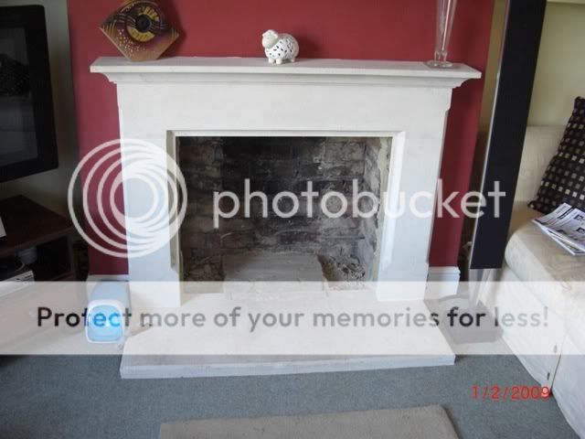

Following the sad and slow death of our gas fire we have decided to rip it out and go for solid fuel (wood) open fire.
The corgi chap as removed and capped the gas and we are now left with a hole 17" wide, 23" high in the mantle and approx 17" deep.
The hole is square with no shape or profile.
The rear face comprises red bricks with evidence (sooty) of a previous fire. The sides are lined with clear 'thermalite' (sp?) blocks that I would guess would be unsuitable for use adjacent to an open fire but would welcome thoughts.
So, the main question - what do I need to do / install / replace (thermalite blocks?) to have a real fire in the space?
(I have already booked to get the chimney swept as we do not know when this was done last).
Thanks.

Thanks chaps. I agreed with Jason's hunch - that the real thing was bigger and had been reduced to accommodate the gas fire.
So, out with the lump hammer (not L-N!) and time to make some space!
I was encouraged as almost no brick dust ended up in the room as it was all drawn up the chimney - a good start I think!
This is where I am up to now. I am not really sure where to go next -
* whether I need to do something by way of lining the cavity?
* whether the small concrete base simply needs extended to fill the gaps at the sides where the thermalite bricks were or whether concrete is suitable for the base of the fire?
* even whether I now have too big an opening which may cause problems down the track.
Still - never learned anything by not trying!
BRgds
Simon.
BEFORE
DURING
AFTER

You need a pre cast cocrete back and throat, and this is normally built with the surrond off the wall.
Have a look at this pdf.
http://www.solidfuel.co.uk/pdfs/opening ... eplace.pdf

What's the rest of the floor made of? If it's a suspended floor, or the fire is on an outside wall, then I'd strongly recommend a Baxi underfloor draft fire. This gets over the problem of howling gales on the back of your legs, and has a huge ashpan which only needs emptying ever few days. BUT, of course, you have to dig up the hearth to fit it.
To fill the space you've created, either use a precast concrete fireback like SP recommends, or you can get 4 section firebricks that form the back and sides.

The overall purpose we have in mind is to look good and add a bit to the room on a Fri / Sat eve + sunday. The heating is really taken care of in terms of the normal central heating.
With this in mind, do we really need the concrete back and throat? I had some sort of cast iron basket / back in mind.
Hopefully the sweep will be out sometime this week - interesting to see what he has to say!

It all depends. Fireplace dimensions (not the basket - the opening) are critical as is height of firebed. Romford is your man.

Chimney sweep been out today and cleaned chimney (3 buckets of cr*p + hoover debris) which was well overdue it seems.
We lit a small fire last night (couple of pages of newspaper + small offcut from shop) - the fire drew like a dream!
The raised centre section on the base of the fire I thought was concrete was found to be more thermalite bricks with a 1/4" skim so has now been removed. - This prompts a question:
We now have the option of whether to fill in this 2" deep 'hole' behind the stone hearth or to leave it as a mini 'pit' wich would make control and clearing of ash easier. Any thoughts?
Given the successful mini fire we have decided to go for a cast iron back and give the shaped concrete back a miss (for now) as all seemed to go well. Looking at these on the 'tinternet it seems one can pay a wide variety of prices for nominally the same item (excluding antique which are mega bucks). But a new back ranges from £140 to £530 for the same item. Is this simply some are profiteering or is there some rubbish out there to steer clear of?
anyway, thanks to you all who have commented so far, very much appreciated - it all goes to making the community we have here that extra bit special and therefore valuable!
