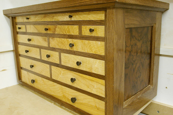

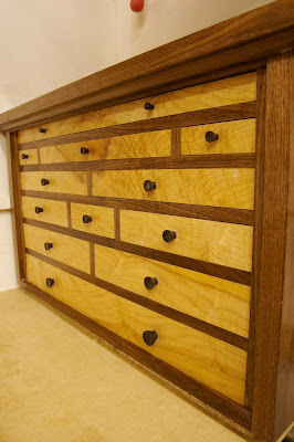

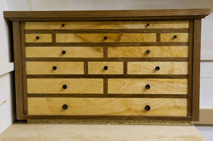

Right, firstly, apologies for the lack of updates. For some reason, the last bit of a project always goes slowly for me, but anyway, it's finished!

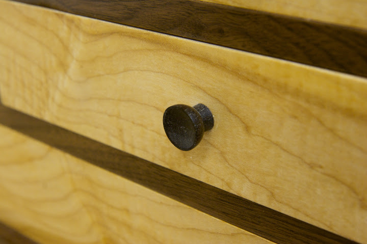

After appealing for help on the round forum, Maltrout512 very kindly agreed to turn me the knobs from african blackwood. I have to give him full credit here - he's a top bloke and an outstanding craftsman and I was absolutely tickled pink with what he made for me. They're tapered in diameter from 18mm down to 6mm at the top, and the projection out from the cabinet gradually gets smaller also.
On his recommendation, the really small ones are attached using brads superglued in.
The finish is wiped on poly. I was hesitant to use it at first because I was afraid it would yellow the maple too much, but in the end I'm pretty pleased. Thinning it and applying lots of light coats with lots of cutting back in between gave me a finish which doesn't feel like plastic (as I've found in the past). I think I'll be using this technique again in future projects.
Anyway, without further rambling, here is the final result:

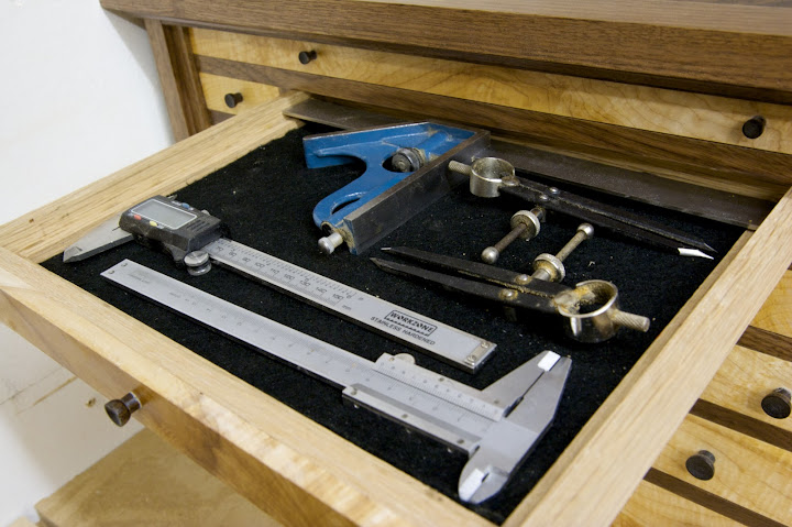

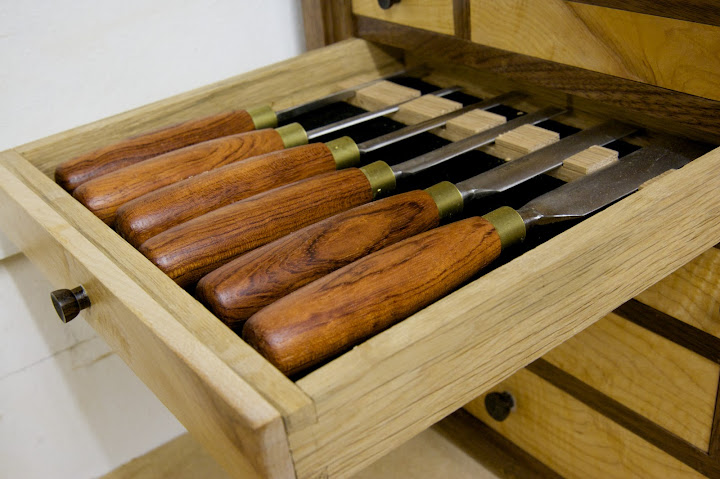

Now a quick tour of the contents (which I'm still changing my mind about)
Note the room for expansion Wink:

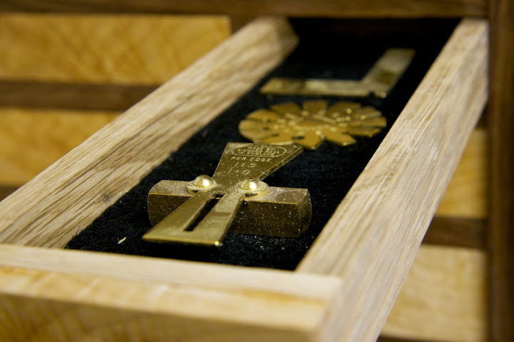

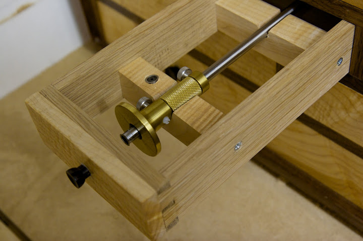

Here is my solution for holding my tite mark:

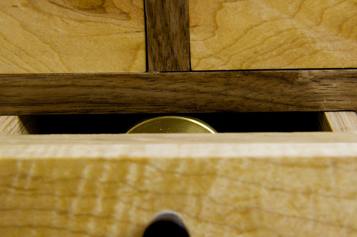

There was only a millimeter of clearance in the opening - I guess thats the price you pay for being a software engineer - always looking to make the most out of every resource:

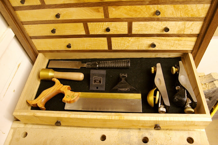

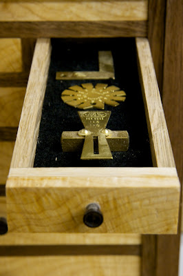

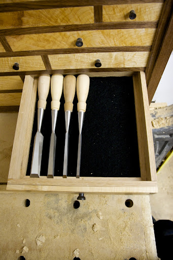

This drawer is especially for my secret santa last christmas, I though his kind gifts deserved a nice home (and I'm ashamed to say that until now they've been sitting on a dusty shelf...sorry Whistle )

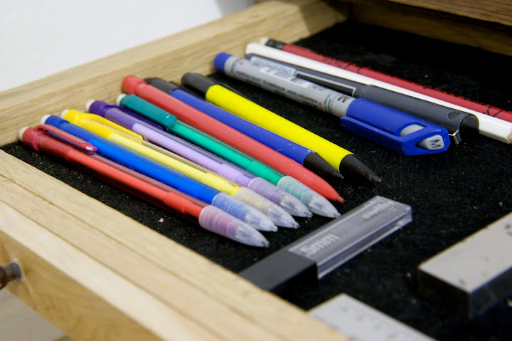

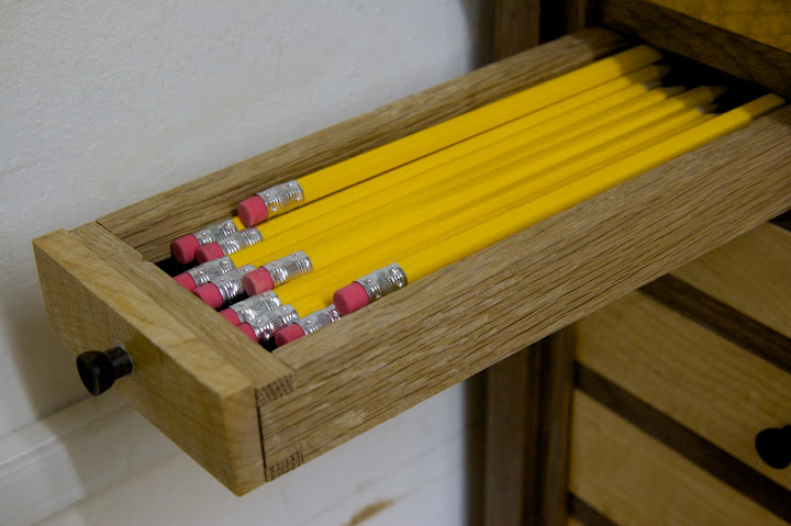

This is what happened when I complained to the Mrs that I could never find a pencil:

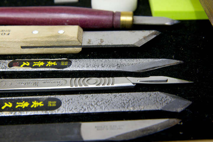

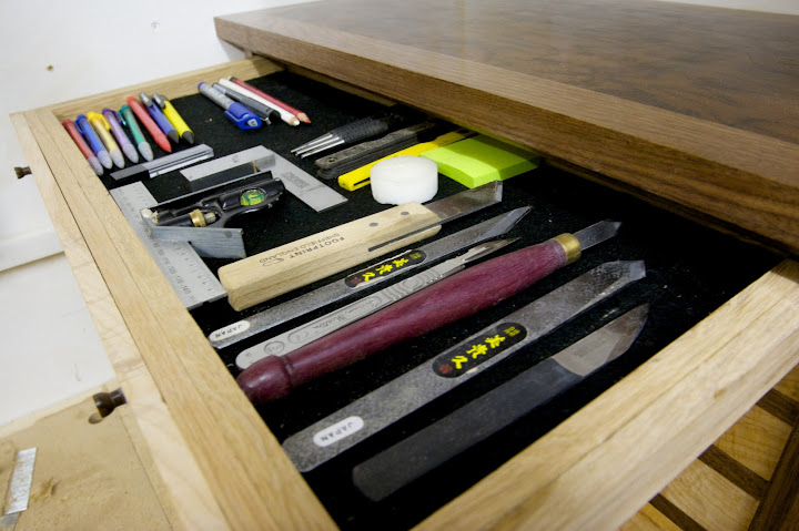

And pointy things:
Finally, here's a closeup of one of the knobs - thanks again Malcolm Very Happy

Very nice Tom.
One day I'll get round to something similar.

Fantastic! I especially like your knob..s Wink Well done Malcolm. He is indeed a great turner.
You can be dead proud of that Tom. It's really nice....and I really should do something about my tool storage as my current arrangement is shocking.

you have put a lot of time and effort in to making this cabinet, i love the drawers and tiny little knobs, good contrast colour wise , that was a nice touch the drawer with no bottom as well , but, please get rid of that crappy piece of chip board underneath it and build a proper plinth to sit it on, it's that finishing touch to it . its really well done don't spoil it .hc Very Happy

The plan is actually to build a workbench to house it, but you're right, everything else is looking decidedly shabby by comparison now

Fantastic!
I wouldn't have thought of different sizes for the handles, they look great.
Well done.

Great job. The handles finish it off really well.

That looks fantastic! Applause Plenty of tools but still plenty of space to fill! Very Happy Wink
That finish looks good too. Is it from the General Finishes range?
