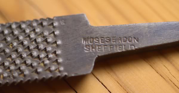

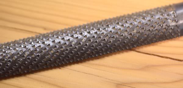

Found this in a box of tools from a car-boot. Wondering if this is a hand-stitched rasp?
It's about 7 inches in length - excluding the tang.
Seems quite old and Moses Eadon seem to have disappeared long ago.

Looks a bit too uniform to be hand stitched?
I have a similar Nicholson one and an even coarser one that I cannot identify.

I would say machine-made :1) the teeth are perfectly aligned from bottom right to up left (more obvious on the top picture) ; 2) even if quite dull now they were round-shaped (easier to do than triangular shape, these is why machine made have this shape) ; and 3) they are not "handed" (aligned towards the tip of the rasps, not silghtly directed towards the left or on the right for left-handed or right-handed persons).
