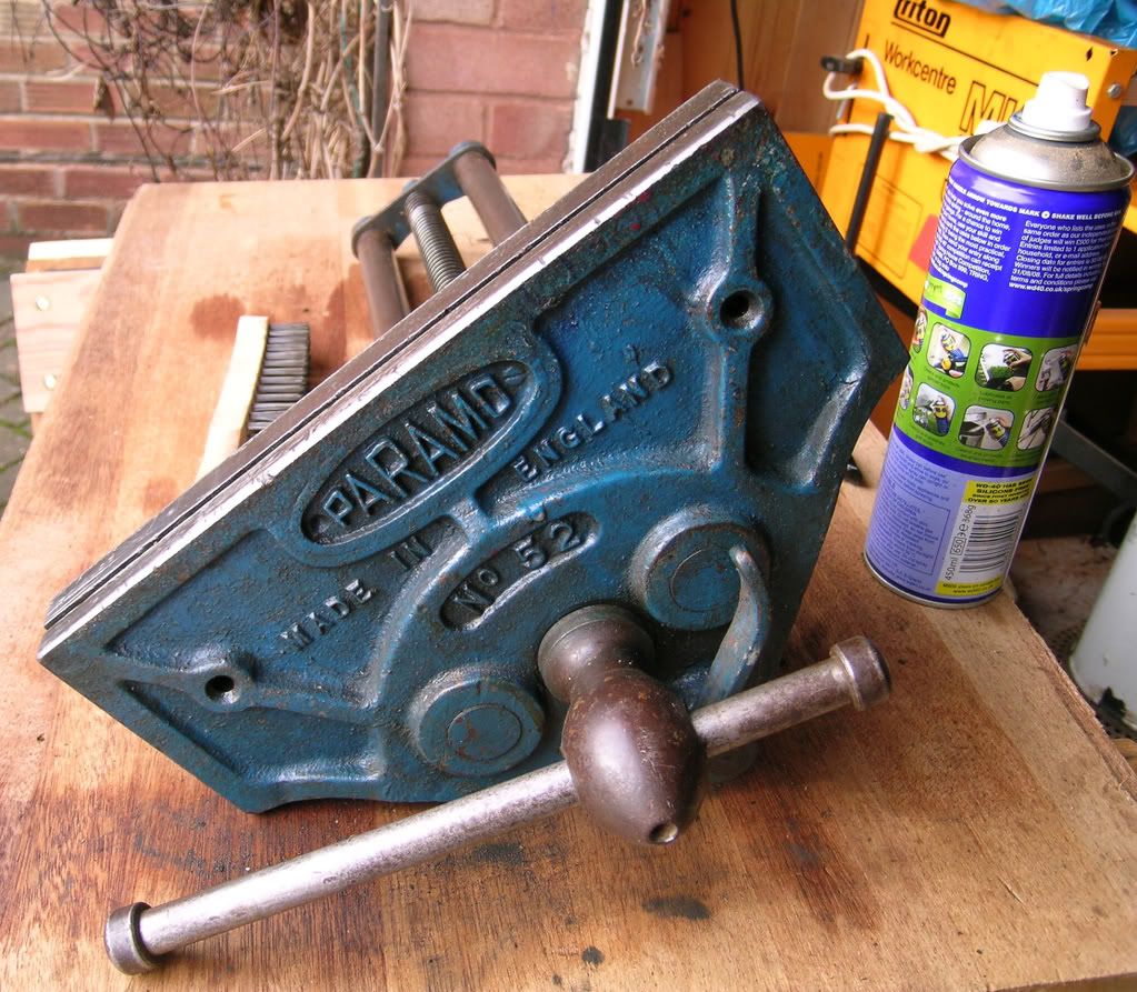

At the moment, I use a Record 53 and 1/2 (Or is it 52 1/2?) with a metal dog in the top. It's okay, but not pretty, so I'm going to use my old Paramo 10" again. It's been clamped to the rafters long enough!

Oh well. the Paramo has always been good to me, and there's nowt wrong with it! :D

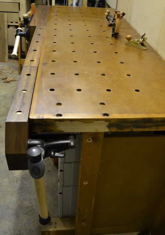

Like Dave, I went for a pair of 52 1/2`s using one as a tail vice on my bench build last Xmas.
I went for large beech jaws so I could drill dog holes that line up with the holes in the bench
So far i`ve been really happy with them.

Paul Chapman":bs68xhcx said:
Why did you put the tail vice on the same end as the front vice, Doug?
Cheers :wink:
Paul
Made more sense to me to put it there for the woodwork I do Paul.
I prefer to finish my planing stroke off the table, so I can clamp panels such as the one in the photo & do that. If I planing an awkward shape I can clamp 2 pieces of wood in each vice & they act as a corner bench stop.
Also being right handed when sawing planks off the end of the bench the right hand end is free of hardware to possibly hit (hammer)
I`m not claiming it to be the right way to do it, god forbid :lol: It just works for me :shock:
I think I`ve just had a Paul Sellers moment :lol: :lol: :lol:
